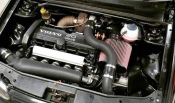

Wed Oct 13 16:41:04 CEST 2021    |    Anarchie-99
Genialer Umbau für einen 3er Golf.
https://www.youtube.com/watch?v=AxjjXSscD4o
Specs:
· Volvo 850 2.3 T5 Engine conversion
· Hybrid VW Volvo Subframe
· Custom driveshafts
· Quaife Qke45z
· Quaife ATB®? Differential Front & Rear
· Sachs 184mm RCS Twinplate Clutch
· Wiseco pistons
· Pauter Rods
· Newman custom Grind camshafts
· Solid lifter conversion
· Id1700x injectors
· Maxx Race Ecu
· Large Fuel Cooler with cooling fans
· Custom adaption from Volvo AWD Gearbox to VW 4 motion transfer box
· Syncro Rear Axle modified to run a Haldex Rear Diff
· Xona Turbo
· Custom Exhaust manifold
· Custom Inlet manifold
· 1000hp Garrett intercooler
· Custom 2.75" boost pipework
· Custom 3.5" Exhaust
· Rear Radiator setup
· 17" & 15" Wheel sets
Unterboden Ansicht:
https://www.youtube.com/watch?v=aMVYR7i4p9k
