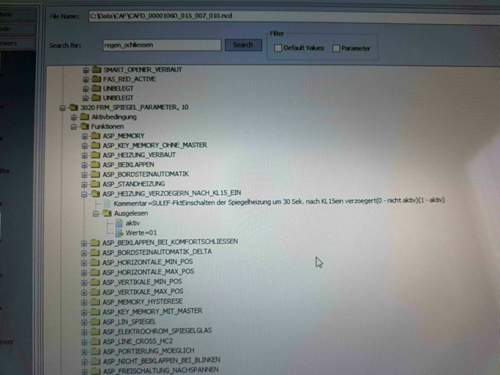

I was looking if there is a way to get the side mirrors heated even if it it is not freezing.. My F10 sleeps outside and sometimes i need the side mirrors to be heated because off the fogg...
I found this entry abouth the heating of the outside mirrors but dont know what it means.
20171004-140841
@TwointjePan schrieb am 4. Oktober 2017 um 14:20:55 Uhr:
The heating of your mirrors is on as soon as the engine starts.No need to code something.

If my mirrors are heated from the moment i start my F10 then there is something wrong and i have to go to the dealer because they dont work. Last week it was foggy out side and in the morning my mirrows where all foggy and after 20 min they where still not clean the rear window was clean after 10 minutes..
Hello!
The heating system inside the mirrors has one dependency, the temperature outside.
