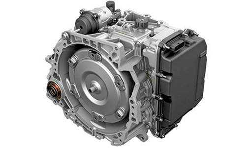

Ford and GM together are the biggest Automatik Transmission Producer. The Transmission from the Focus had newest Hardware and it is in many parts similar to the 10 Gear Transmission from GM / Ford. Only the Software would Not build together. I didn't know about similar Problems at GM with this Transmissions.
Numbers do not mean quality. Just look at the Powershift transmissions. The 10-speed auto which is developed by Ford is not similar to ours (petrol: 8F24; diesel:8F35). We got a modified version of the GM 9 seed. Ford could not justify the extra cost of the 9th gear because it did not decrease the consumption significantly. So they figured "hey let's do it with 8 seed". Now we are facing that decesion. That extra gear is responsible for the smoothness. I don't think they can ever fix it by working on the software alone. My car (2018.10) ran perfectly smoothly for the first 5-6000 km. Since then I am experiencing low gear (1-4) jerking and shift delays with normal acceleration. Driving in a traffic jam is horrible. Another example when I cancel my cruise control in town (set to 55 km/h) to slowly decelerate, the car shifts up, causing a slight acceleration, then immediately shifts down and causing the car to bounce. Something similar happens in traffic jam also, but the speed is to low to get this feeling. The shift paddles also have a delay. Something is bottlenecking the whole shifting process.
8-speed
10-speed
The powershift Transmission are not from Ford. Powershift is a Getrag Magna Product.
It is correct, that GM produce a 9 Gear Transmission and Ford an 8 Gear.
Many Internal Hardware parts of all new transmission of this family... FORD 8 Gear, GM 9 Gear, GM 10 Gear and Ford 10 Gear are the same. Only at Software development, Ford and GM go there own way for this Transmission familiy.
Ich hoffe, es ist verständlich, was ich damit sagen möchte.
So, It is possible that Ford has problems and GM don't know about that.
The 10 Gear Transmission in the Ford Mustang haven't Problems with delay or other things. The 8F for the Diesel Engine's are inconspicuous.
