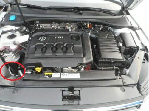

@sskkaa schrieb am 26. Mai 2021 um 09:33:00 Uhr:
Hello all
I have solved the vibration noise problem, in about 80-90%.
The problem was that when the engine and gearbox went down for flywheel replace, when the first service mechanics put everything up on the car, the engine was not perfectly aligned.
So, after 20k km, the engine and dsg mounting/supports where damaged, so i had to change them
The orignal part codes were:
3Q0199262J and 3Q0199555J
and also to realign the engine.
Now most of the vibration sounds are gone.
Well, after 55k km more, i found out that all the noises were made from a climate pipe that was out of place and resonated into the case of the fuel filter.
Now, complete silence in the car, just perfect!

At first, i would change the Engine and Gearmount.
My Engine and Gearmount was broken After 180tkm
Now it feels like better
Hi, all the supports for engine and gearbox were exchanged at 120k km, and now at 175k km only the hydraulic engine support had to be exchanged again, the upper one, on the left ( as you look at the engine from outside )
Now it's all quiet.
All the problems started when in P, at idle i had some vibrations.
First the engine support was exchanged, the, the fuel regulator, then the fuel regulator from the injection ramp, and in the end the dual mass flywheel. ( which was the problem )
