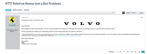

Heute in einem englischen Forum gefunden.
Sieht so aus, dass wir unseren Händler besuchen müssen.
https://www.volvoforums.org.uk/forum/technical-topics/s60-v60-18-xc60-17-s90-v90-16-xc90-15-general/336001-rtti-failed-on-sensus-not-a-sim-problem/page26?view=thread
Bildschirmfoto-2025-07-15-um-18-47
Habe nun zum dritten Mal bei Volvo angefragt und diesmal etwas forscher als üblich. Innerhalb von 2 Tagen kam prompt eine Antwort. Die Antwort deckt sich mit der Aussage des vorherigen Posts. Es scheint also doch was zu passieren.
Dear xxxxxxx,
We sincerely apologize for the long delay in resolving the RTTI (Real-Time Traffic Information) issue, we fully understand how important this feature is to your driving experience.
We’re reaching out as quickly as possible to let you know that the fix was just released today for you Volvo. To restore RTTI functionality, the update must be performed at your Volvo retailer. They will be able to perform the necessary installation and get RTTI functioning again.
We also want to apologize for the English in this message, our team wanted to respond to you as quickly as possible. We’re currently experiencing higher than normal call and email volumes, but we didn’t want to delay getting this important information to you.
Please let us know if you need help booking your appointment or have any other questions. We truly appreciate your patience and continued trust in Volvo.
