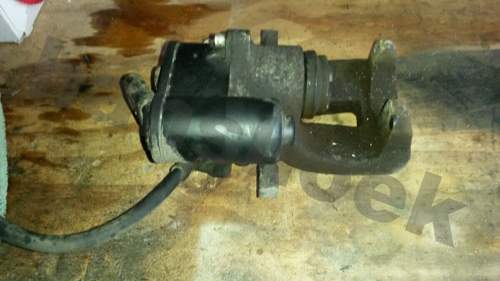

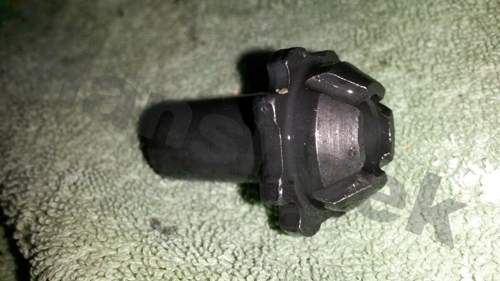

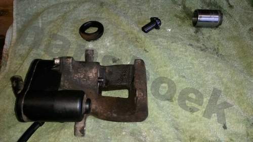

Hello all,
I think Zerozen is right about the pistons getting stock in the cylinders. This is mainly a result of the rear break pistons move very little distance and are not so much loaded as the front breaks. Maybe the form of the notch where it remains onto the caliper has also influence, the bend angle differs.
I while ago I also experienced very hot rear breaks :mad:. So I cleaned the whole lot, smoothened the pistons with scotch brite and replaced the rubbers. As I could not find a lot of info I made some pictures to share with you.
I ordered Bosch break pads but then I noticed this post on MT. So I send them back and used ATE instead (without the noses). Just to be sure.....
The work on the caliper is a bit complex as the screw that operates the parking brake is in the way. Therefor I used this guide: Brake caliper rebuild on Youtube
Note: The nut must be placed into the piston just the way as it came out.
After completing I had an error in the coding and several warninglights on the dashboard and the parking break button blinking. Did not disappear after resetting the error :confused::confused::confused:. When I drove just a few meters it went all back to normal.
Please excuse me for using English; I can understand and speak German, but writing would be a disaster :rolleyes:
Greetings and good luck,
Hans

@hanshoek schrieb am 27. April 2016 um 20:27:50 Uhr:
In den Bildern von Hans sieht man gut wie der "Adapter" wie ich geschrieben habe auf dem Gewinde und im Kolben fährt.

Hi Madwerk,
You can hear the EPM motor running for a few seconds when you use it.
If you do not hear it spinning , the "adapter" is not moving. This is very unlikely as it is running in the breaking fluid, so it is lubricated and "clean".
I think your pistons move heavy and you need to do the same repair as I did.
Maybe you, or other people with the same issue can post some pictures?
Greetings and good luck!
Hans
