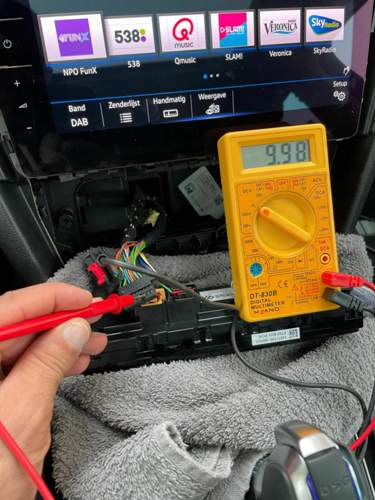

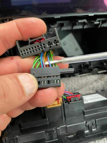

What would pin 16 give ?
This is the LIN Bus connection. The question is there a pin in place there (i.e. coming out of the panel). Your original panel definately has a pin there. I enhanced my comment on page 51 to make things a little clearer.
I check
Could it also be the gateway.
I hear that only a 3Q gateway support the 3 zone area
No, if your old knobbed climate control works with the rear zone & panel, then it can't be the gateway. It might be the software version of the rear panel is too old to work correctly, but thats only a hunch and I would assume that it would at least turn the display on, since the "power up" message on the LIN bus is still the same.
What you can do is delete the 08 from the installation list in the gateway. Save the values and close the controller (gateway) in VCDS. Switch off the power via the Start/Stop button. Turn the power back on and reinstall the 08 in the installation list of the gateway via VCDS. That way you will force the gateway to re-read the config info from the 08 and it's subs. Sometimes this helps, although I have never needed to do this on a climatic control unit.

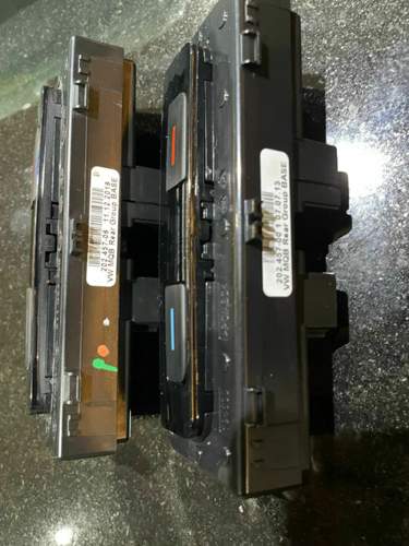

I even bought a rear panel from a 2020 as you can see on the pictures before. I also thought mine could be to old. But I placed a 2020 version and still displays stays off
I see pin16 is occupied
Yes, that was clear. I meant look where this plug is plugged into (in the climate control panel) The question is if there is a companion pin there.
It is on pin 16 and same colour at the back on pin 1

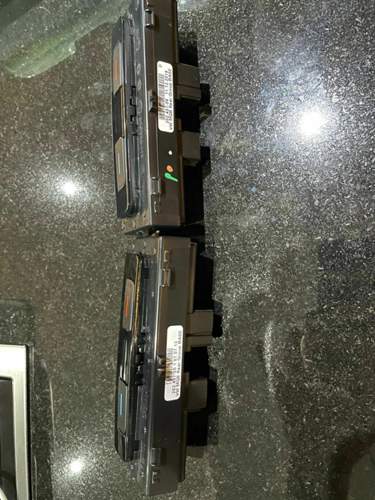

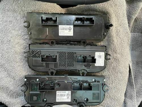

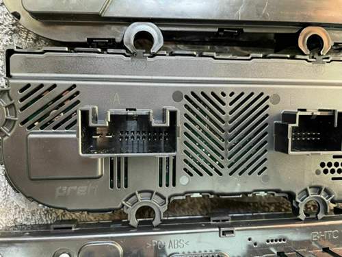

Yes, beacause that is the cable going from the front climate control to the rear climate control (the LIN Bus cable) What we need to find out if there is a connection going INTO the front climate control panel. If the >panel< (NOT the plug) has no pin on the 16th place, then there is no connection between the electronics in the front panel and the electronics in the rear panel. Please take a hi-res picture of the OLD climate control panel (20 pin connector) and a ditto picture of the NEW climate control panel.
Ok on top is the orginele touch panel from VW
Middle one from Aliexpress
Bottom is my old one
+2
Hmm, Pin 16 is there on all three panels. I am slowly running out of ideas.
If I understood you correctly the only FRONT panel that works in conjunction with the rear panel is the orginal "5GE" one? Neither Ali nor the new original VW panel bring the rear panel to life?

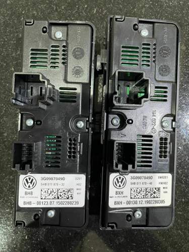

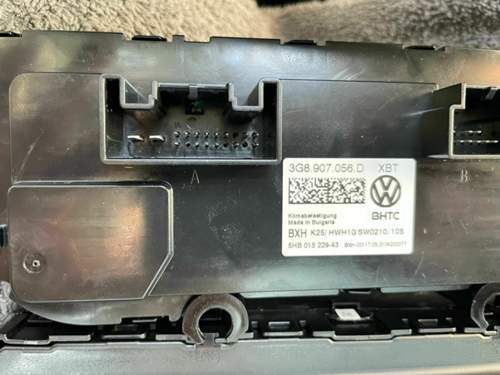

@monstermolt Du fährst doch auch einen GTE, oder? Hast Du das gleiche Panel wie jimmy drin? Also das 3G8 907 056(D). Beim hinteren Bedienteil wird so weit ich weiß nicht zwischen "normal" und GTE unterschieden, sondern nur ob mit oder ohne Sitzheizung hinten..
I try little Bit deutch
Das einzige wo das hinten display functioniert is das alte 5GE
Vielleicht kann jemand mit eine Passat GTE mit touchpanel, Sitzheizung und hinten display eine Scan Posten
Hast du schonmal das hintere Panel gegen ein aktuelles getauscht? Evtl. mal auch dort gegen das Touch Panel tauschen.
Ich habe eine aus 2020 eingebaut, kein Touch. Weil den im showroom beim VW wo ich das vorne Touch teilnr von habe auch kein Touch war.
Hier den link von de Passat GTE aus den showroom beim VW
Ich habe dort am VIN nr das teilnr von vorne clima Touch dort erhalten 3G8907056D und hinten den 3G0907049D
