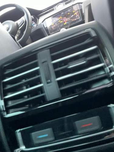

Aber immer noch keine hinten display aktiv

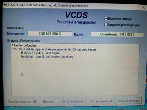

Kann jemand mir sagen ob die pin (Belegung) beim neu anders ist ?
Alte : 5GE907044AK
Neu : 3G8907056D

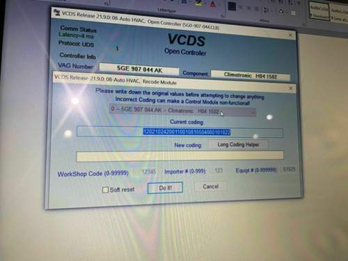

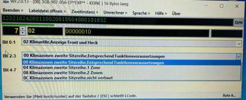

@jimmyvw

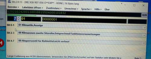

Warum hast du bei Byte 7 hex 2 und nicht wie normal Hex 01 oder 0000001
Habe es Geändert aber immer noch Fehler Display hinten

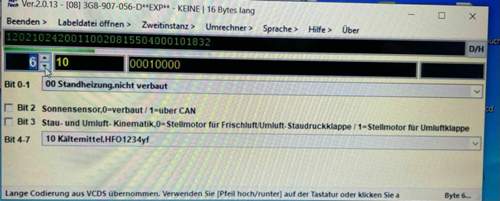

Hast du hinten den als sub stg drin?
Habe diese hinten
.jpg

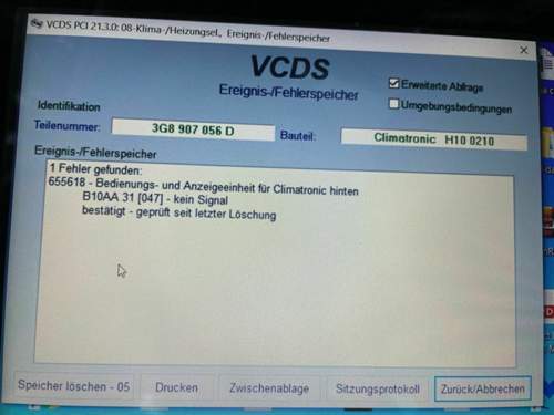

Okay, I had a look at the new scan that you sent me.
Address 08: Auto HVAC (J255) Labels:* None
Part No SW: 3G8 907 056 D HW: 3G8 907 056 D
Component: Climatronic H10 0210
Coding: 12021024200110020815504000101832
Shop #: WSC 12345 123 12345
ASAM Dataset: EV_AirCondiBHTCMQB3rTranc 001052
ROD: EV_AirCondiBHTCMQB3rTranc_001_VW48.rod
VCID: 313EE9FC61AF635318F-8064
Auxiliary Air Heater Control Module/PTC:
Subsystem 1 - Part No SW: 3Q0 963 231 HW: 3Q0 963 231
A/C compressor sub:
Subsystem 4 - Part No SW: 12E 820 803 E HW: 12E 820 803 E
Component: J842 eKK H02 0005
1 Fault Found:
655618 - Control/Display Unit for Rear Climatronic
B10AA 31 [047] - No Signal
So your rear climatic control is not showing up as a sub-system
of the control unit 08. It has to show up just like your A/C
compressor sub.
Additionally to the test request from yesterday, please also check the fuse SC-7 and measure pin 2 of the 6 pole plug that goes into the rear climatic control, to see if you have 12V there. I don't think the fuse is blown, since there are more parts of the car that receive power from that fuse, but maybe there is an open connection to the rear unit. Power here is "Klemme 30", so 12V are always there. There is no need to switch on the ignition to measure it.
If you have heated rear seats (I don't think so) also check fuse SC51.
Edit2: You can also check if the LIN Bus system has continuity. To do this pull the 20 pol plug from the front climate control unit, find pin #16 (it has a violett/ blue (NOT blue/violett!) wire connected). Take off the 6 pole plug from the rear climate control and find pin 1 (also a vi/bl wire). You should measure close to zero ohms. Finally measure from pin 3 to chassis (like to the door latch e.g.). Here, too almost zero ohms is good.
If all values are good, we can rule out an electrical problem on the cable loom.

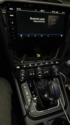

As you can see. If I put old one back the rear works. If I put new one the rear is off. Coding is same.
And even with old one I do not see a sub menu
.jpg

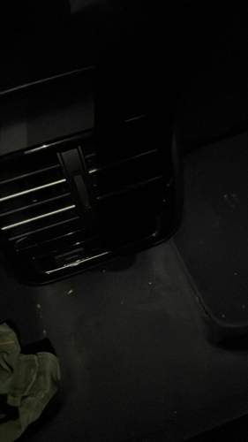

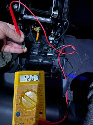

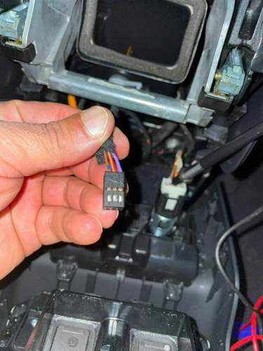

Also as you can see at the rear it has 3 pins filled.
I measure pin 2 and I see it has 12v. The other pins like 1 and 2 are 0v
By the way the colour at the back at pin 2 is orange red
.jpg
Well actually it is red/yellow 😁 Red is the main color and yellow is the coding color.
The other two pins are gnd (which is why you are seeing 0V with a DMM) and the purple/blue is the LIN bus. You can't measure that with a DMM. You would need an o-scope or signal analyser to see something there. That is why I said do a continuity test, just to see if the wire doesn't have a break in it somewhere in the loom. However, your swap test did basically the same. This means your cable loom is okay.
