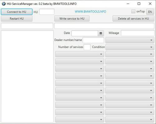

Hello everybody...
IToday i found this little program on the internet ,(Russian BMW Tools site )
It is a little program that cald (HU-ServiceManager ) lets you put service intries in the HUD..
Anybody know this program.
