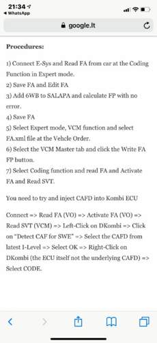

Hello I need help with 6wb instrument cluster on f30, everything is connected, but I have problem with coding, always showing just Bkombi, not appearing Dkombi
@Simonaa schrieb am 31. Mai 2019 um 21:24:07 Uhr:
Did you change your FA?
@Keibir schrieb am 31. Mai 2019 um 21:25:11 Uhr:
Yes in Fa I wrote 6wb
And coded it to HU? (Not FDL edit)
No I dont coded in to the HU, Im new in all this stuff. And I don't understand to much of all this meaning
Load the changed FA and code (not FDL code) the HU.
After that try again to read VCM or Read Ecu.
How can I enter in to the Hu?
Go to “Expert Mode” then “Coding”.
Click “Read(ECU)” button and pull down the items display on SVT box.
Read and activate your FA.
Code to Kombi and Hu
@Simonaa schrieb am 31. Mai 2019 um 21:42:30 Uhr:
Load and activate the FA
Read VCM or read Ecu
Mark the HU and hit the button "Code".
HU
And to read Ecu I need to choose something from ( single flash and etc)?
No nothing from that
