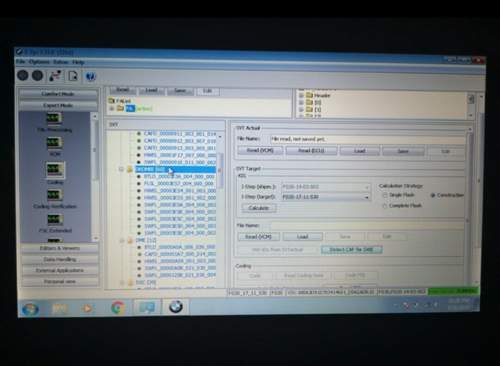

Do I need to choose this (single flash, construction, complete flash)
No nothing
Thank you, now I have Dkombi, And what CAFD to choose because shows a lot
It doesn’t matter. Choose the newest with the highest numbers.
The last step choose Cafd and finished? Or do I need code something more?
You can now try if it works correct.
If not there are maybe some things to code.
Now shows this, then I push (detect Caf for Swe) shows this error
Which version of the psdz?
63.3 lite now Im using, and I have 50.3 full too
Was it a new one the 6WB?
I think 6wb for F3x was not available until mid / end of 2017. Your 63.x psdzdata could be a bit too old, depending on the software version of the 6wb.
No, was used, but was cleared and changed the vin
@Stromag schrieb am 31. Mai 2019 um 23:25:44 Uhr:
Do you know where I can download the latest version of pszdata?
Look in your inbox, these are very current.
After that then error pop up, I updated psdzdata v4. 17.20, and connected esys, to create Cafd, but the Dkombi is missed and now I dont cant see Bkombi and Dkombi, do someone knows how to fix it?
