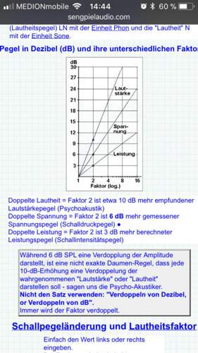

Du kennst schon den Unterschied wenn etwas 60 db hat oder 63 bd hat?
Ich bin zwar auch kein Experte in der Hinsicht
aber ein unterschied ist deutlich zu hören.
Hier mal ein Auszug aus dem Internet.
.jpg

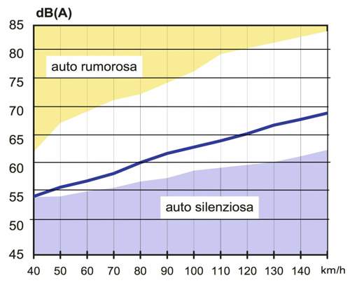

Yes, I know very well the differences. dBs only is part of the story. dB's tell you about the amount of sound, not the sort of sound. E.g. wind noise sounds different from motor noise. Sound levels are measured A-weighted, to adapt the sensitivity of the human ears.
The GLC has relatively quite some wind and tyre noise, and hardly any other noise. Aside from engine noise, the GLC sounds a bit like the wind noise you get inside an aeroplane (less loud of course; the type of sound is well recorded in this movie: https://www.youtube.com/watch?time_continue=6&v=L2hlJc9JEIw - the dB levels reported in that movie look like they are non-calibrated and too low). Because the car is very silent at low speeds, with harder speeds the differences are very obvious. I think most people are sensitive to the type of noise, not so much the amount. My guess is that the roof is not isolated enough.
Enclosed is a graph showing the differences of the noise levels (not the type of noise) at different speeds for 4 cars (source of the data is the Italian Automobilismo magazine).
Some experience after adding acoustic glass can be found here: http://....mercedes-benz-passion.com/.../
Noise levels compared
GLC noise level
