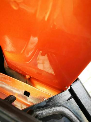

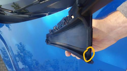

On Picture2, see the white scratch in the bottom right? Probably caused by the plastic cover.

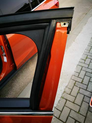

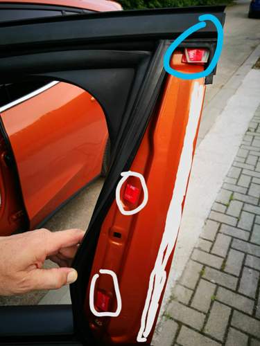

Picture1:
In blue circle, we eventually kept only the tape below the plastic part, between the plastic part and the door.
As I forgot to take a picture - the white area on the edge is taped with one layer of isolation tape, coverin also the edge and ending on the inside side.
In white circles on the left, is doublesided tape, only sticked to the door. A little hole inside since the screws go through it.
Sorry for not writing in German. This is easier for me... 🙂
Hope it helps. I just applied this. It is quiet, but is not hot outside anymore. Will try it tomorrow.

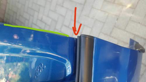

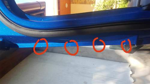

I have also removed the plastic trim piece a while ago. I have found the following:
The painting is damaged (red marks) by that plastic due to vibrations. Damage made by the part marked with yellow.
I have applied tesa cloth wire-harness tape on the painting along the edge (green line), so the plastic trim piece touches the surface of the tape only. I did this mid 2019 on the driver side doors. Since that it doesn't make any sound regardless of temperature.
Later this year I will do the other side to, and I will take pictures.
