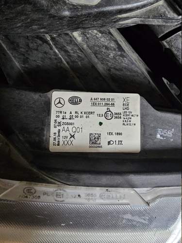

Someone was talking about the light part model...i checked it on my vehicle and it has de Hella ones.
So can anyone confirm about the possibility of activate it?

@jmola schrieb am 6. November 2024 um 21:25:29 Uhr:
Is your car equipped with the standard ILS that automatically switches the high beam lights on and off with traffic ahead?
If yes, it should be possible.
If not, next question would be if you have a camera at the top of your front screen (not the 360 one under the bonnet). The camera is needed for ILS+.
Do you have the SA-Code LA2 Headlamp Assist and LG2 LED Intelligent Light System on your equipment list?
You can check it with an VIN decoder.
Then it is possible.

yes I have ILS and high beam goes on and off automatically.
I also have 360 cam, distronic, and also cam at the windshield
I have LG2 equipment but not LG8 that I want
At least in Spain at the brochures, LG8 equipment is named ILS+ (not IHC+). this also cause some confusion to me

finally found someone that could code IHC+ on my vehicle
