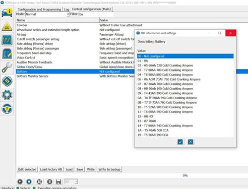

Guten Tag zusammen,
ich habe heute über forscan mal geschaut was die Einstellung der Batterie sagt.
Forscan kann mir dazu keine Werte liefern, er kennt die verbaute Batterie nicht.
Eingebaut ist eine Varta 70Ah H6 von Ford.
Forscan bietet mir aber lediglich 60Ah zum Einstellen an.
Forscan habe ich heute früh von der Homepage geladen, also die neueste Version.

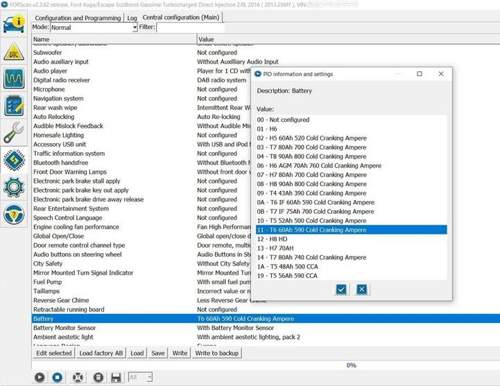

Hi, I have a Ford C-Max2 Ecoboost from 2015, and I can only change two battery settings in Forscan : the current "Battery" and "Battery Monitor Sensor". I would have liked to increase the Battery Target State to 90% or 95%, but it's not possible. Not in Forscan 2.3.64, not in Forscan 2.3.58 and not in Forscan 2.3.49.
I got a new Exide EFB 65Ah 650 CCA battery this year, but did not find it in Forscan, and choose to keep the old setting (OA - T6 IF 60Ah 590 CCA). I wanted to disable Start/Stop, but failed to permanently do this. But becauce S/S kicks in every time, I guess my new battery is fine, although it feels as if this battery is only 50% full most of the time, with low voltages.
In a Dutch FordFocus-forum was written that for an EFB Battery of 65Ah one should keep the "OA - T6 IF 60Ah 590 CCA" setting, where the "IF" stands for EFB. If I had know this before, I would have bought a Varta EFB 75Ah 730 CCA, so I could have picked the appropiate setting "0B - T7 75Ah 700 CCA". Provided it would fit under my cramped C-Max bonnet.
www.focusclub.nl/vervangen-accu
PS, in Forscan 2.3.49 I get the same list of batteries as in Forscan release 2.3.58 or 2.3.64. I can not choose battery nr 34 (Exide 60Ah 520 CCA H5), which I guess is a normal flooded battery and no EFB.
I also briefly choose "Not Configured", but I guess this also results in charging the battery as an regular flooded battery and not as an EFB, which prefers higher charging-voltages.
I would have liked to be able to pick the correct battery in Forscan, and also to be able to simply disable the Start/Stop function. But I give up on Forscan now. They have made it to complicated/impossible to do.

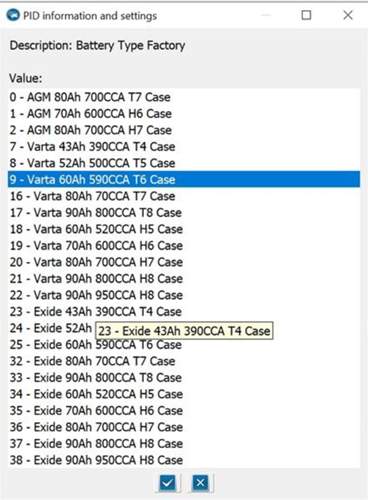

A hint for you from my experience:
Do not rely on the values behind the battery type numbers. Forscan is not correct here. Ignore the text.
First remember your type number before changing (even when it is claimed as false or not configured)
Then change both types factory and default.
After that check all of BATT_ values in the oscilloscope section of forscan.
These readings seem to be correct.
If you like you can change back to your originally values - and then sell the car to a dealer as quick as you can 😉.

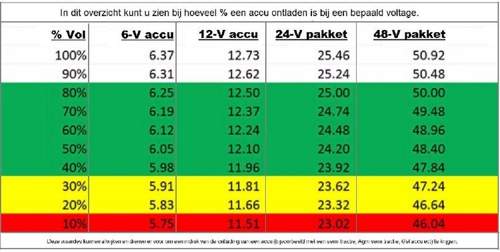

Brace yourselves...I want to share this before the year is over, partly to note it down for myself, partly to help others (maybe) understand how BMS works in practice.
On Friday I measured my Exide EFB 65Ah battery with a multimeter before starting my car, and it indicated 12.10 Volts. Personally, I think that's quite low, but the car started well, and Start/Stop also worked (which I usually turn off). After driving 20 kilometers, with 5 stops, I measured my battery again when I got home, and it now indicated 12.25V.
When I used Forscan last week, it indicated that my battery was charged for 82%, even though I had just charged it to 100% with a battery charger. Does Forscan use that much energy from the battery when it is connected? Or does Ford's Battery Management System trick my (intelligent?) Powerplus charger into thinking the battery is fully charged, while it is actually only at a maximum of 80%, according to the default settings.
Today Sunday, my multimeter indicated 12.25V just before recharging, and 12.85V immediately after fully charged. However, this only took 2 hours and 30 minutes, and my charger is one of 5Ah per hour. In theory, my charger could only have charged an extra 13 Ah in that time, or about 20% of the total 65Ah. Correct me if I'm wrong.
But here's the thing, at the start of charging, my charger only showed 2 full bars out of 5, which suggests the battery was only 40% to 60% charged. Add then that 20% (from the 2h30 charging), and you get a maximum of 80% in total. While my charger indicates that my battery is 100% fully charged.
So, could it be that Ford's BMS limits the maximum percentage of charging to a maximum of 80%, not only while driving, but also when charging with an external charger ? Even though my charger thinks and indicates that it has charged to 100%?
Now, 4 hours after 'fully charging' my battery, my multimeter indicates 12.48V, which according to the table would indicate 80% of the battery capacity. As mentioned before, I can't increase this to 90% or 95% via Forscan unfortunately.
Do you guys understand what I'm writing here? Does it makes sence ? I think that my EFB battery constantly fluctuates between 40% and 80%, and that I can not charge it to 100%, not even with my external charger, as long as the battery is connected to the car (and the BMS). Which has led to some (considerable) confusion for me, because I did not expected this.
