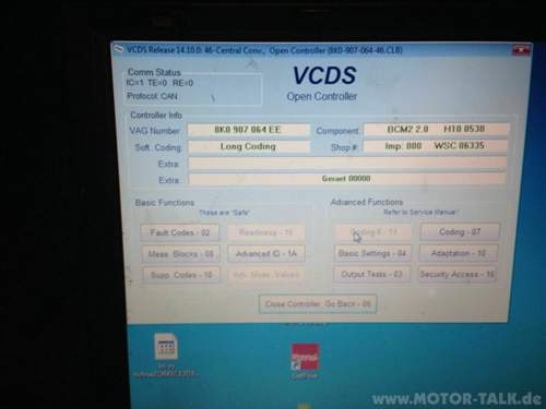

I have a q5 from 12/2011. Have just installed original led plate light but her error in Fis.
I have a Ross-tech cable. Anyone thAt would be kind to summize what to do?
Stg 46
Login
AP 192 auf 0
@Scotty18 schrieb am 21. November 2014 um 18:48:56 Uhr:
Stg 46
Login
AP 192 auf 0
How to get access? See picture.
@trabjerg schrieb am 21. November 2014 um 20:48:37 Uhr:
Stg 46
Login
AP 192 auf 0
-> security access
enter 16017
then go to
-> adaption
enter scotty´s values
