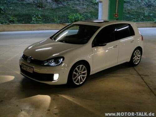

What do you think abot that challange. If your car has function Coming/Leaving home and when you lock or unlock your car, front lights, mirror lights and back lights goes on.If you have xenon lights it is not good to turn them on and off for so short time.
So challange is to change how front lights goes on and off by function Coming/Leaving home. With VCDS you can program, that insted of xenon lights turns on front LED lights and front fog lights.How that looks see picture (on picture is friends VW Golf VI GTI ).
Can you do that on VW Golf VII?

It can be done, but currently VCDS does not have the SA key code for the new Bosch BCM module (09 Central Electrics) so none of the coding works for the BCM module yet.

Soo - Staging funktioniert mit VCDS!
Danke für alle Infos.
Super wäre, wenn jetzt noch die Codierung der LED Kennzeichenbeleuchtung über VCDS möglich. Zur Zeit ist dies scheinbar nur bei VW mit VAS / ODIS möglich.
