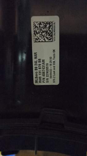

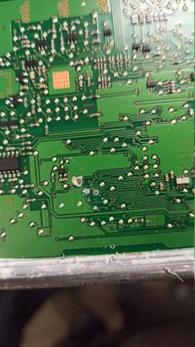

i have also problem with my a4 b9 with adblue sistem. i had almost full tank of adblue and the level sensor died in tnak. I replace tank and stil waiting new CU. three weeks ago, i ordered new CU and it stil waiting for a call. From then pn changed from 355e to 355h but stil not on stock. 240 cars in SLO waiting this CU. i try new used 4M0907335D with new tank and telemetration but no success. if i put on old tank and used CU and VCDS shows same trouble code. i opened original CU and it have corrosion in same spot as all others broken CUs. this membrane inside CU is real problem. originali on my car was tank with PN 8w0131879ba new is bb, original CU have two numbers hw:4M0907335B sw:4M0907335D. i tried all cobinations but no success, i have to wait for new CU, til then my car sits in parking yard.
