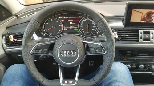

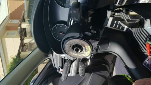

Well ... sorry for writing in English. then I translate everything in german. change steering levers but stop. I think I have to change pump abs. My pump is 4G0907379S but model 4G0614517AK and I think it does not support ACC. The good one is 4G0907379S model 4G0614517AL. I ordered the price in audi and it costs 2,000 euros plus taxes. Audi does not want to change pump. Now I'm stopped. I am looking for help to finish ACC ...... if someone can help ........ thanks ..
Tja ... Entschuldigung für das Schreiben auf Englisch. dann übersetze ich alles auf deutsch. Lenkhebel wechseln, aber anhalten. Ich glaube, ich muss die Bauchmuskeln wechseln. Meine Pumpe ist 4G0907379S, aber das Modell 4G0614517AK, und ich denke, es wird kein ACC unterstützt. Das gute ist 4G0907379S Modell 4G0614517AL. Ich habe den Preis bei Audi bestellt und kostet 2.000 Euro plus Steuern. Audi will die Pumpe nicht wechseln. Jetzt bin ich angehalten. Ich suche Hilfe, um ACC zu beenden ...... wenn jemand helfen kann ........ Danke ..
hier ein paar bilder ...
20190304-162055
20190302-135339
20190302-135332
+3
Hi torre. I have also retrofitted the ACC. I have changed the abs pump by myself. It's not that complicated as you think it is. Swap the unit (fluid loss is minimal), coding is same and then bleed the brakes. I've bought used abs pump on Ebay for 400€ and is as good as new.
If you don't have lane assist you need to change the windshield to add the camera. Last step is to calibrate both the acc sensors and the windshield camera. You also need to add parameters to acc sensors with the VCP. Column switches and the KI needs to be changed also.
You need to remove component protection from the sensors and the KI. If you have any other questions feel free to ask 😉!
