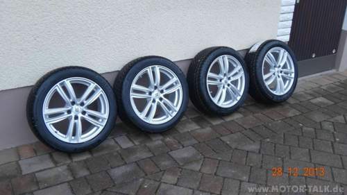

Here are mine......waiting for the car.🙂 Tyres are Continental Wintercontact ts 850 (225/45 17) and wheels are Brock RC-Design RC27.
Dsc01204
Dsc01205
Sehr schick, deine Felgen!
Danke🙂
