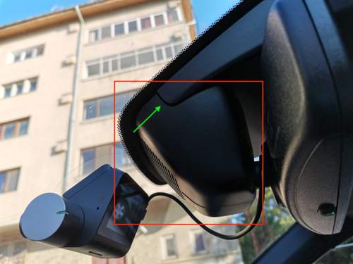

I'm driving my blue sport for almost 5k km now and just wanted to share the 2 things I crossed on during this period. In short there are 2 noises/rattles that I encountered, for one of them I managed to resolve it, but the other is quite new.
Noise 1: Initially I thought it is coming from the multimedia unit or behind it as there it's a piece of hard plastic...it was very annoying while driving especially on rough asphalt or bad roads, initially was quiet but with time got louder. I noticed it at around 2k km. It was driving me insane for some period until I understood from where it was coming. This was actually coming from the establishment of the front mirror, actually, as you will see in the picture, from the piece of plastic that is connected to the back of the mirror. I don't think it's an assembly issue as it was not there from the beginning, probably appeared while driving on various types of asphalt some good some bad. What I did, as the green arrow shows, was to push a bit the plastic piece into the direction it is mounted and since then this noise has disappeared completely. This one was anyway very disturbing, like on scale from 0-10, I would say 8-9 as neither when driving with music this was still there annoying me. If I haven't found a solution I was planning to do to the service and complain about it.

Ich fahre mit meinem blauen Sportwagen jetzt fast 5.000 km und wollte nur die beiden Dinge teilen, die mir in dieser Zeit begegnet sind. Kurz gesagt, es sind zwei Geräusche/Klappergeräusche aufgetreten, eines davon konnte ich beheben, das andere ist jedoch recht neu.
Geräusch 1: Zuerst dachte ich, es käme von der Multimedia-Einheit oder dahinter, da es sich um ein Stück Hartplastik handelt. Beim Fahren war es sehr störend, insbesondere auf rauem Asphalt oder schlechten Straßen. Anfangs war es leise, wurde aber mit der Zeit lauter. Ich habe es bei etwa 2.000 km bemerkt. Es machte mich eine Zeit lang wahnsinnig, bis ich verstand, woher es kam. Dies war eigentlich auf die Herstellung des Vorderspiegels zurückzuführen, und zwar, wie Sie auf dem Bild sehen werden, auf das Stück Kunststoff, das mit der Rückseite des Spiegels verbunden ist. Ich glaube nicht, dass es sich um ein Montageproblem handelt, da es nicht von Anfang an da war, sondern wahrscheinlich beim Fahren auf verschiedenen Asphaltarten auftrat, manche gut, manche schlecht. Was ich getan habe, war, wie der grüne Pfeil zeigt, das Kunststoffteil ein wenig in die Richtung zu drücken, in der es montiert ist, und seitdem ist dieses Geräusch vollständig verschwunden. Das war auf jeden Fall sehr störend, auf der Skala von 0-10 würde ich sagen 8-9, da mich das beim Fahren mit Musik nicht immer noch störte. Wenn ich keine Lösung gefunden habe, hatte ich vor, den Dienst zu ändern und mich darüber zu beschweren.
