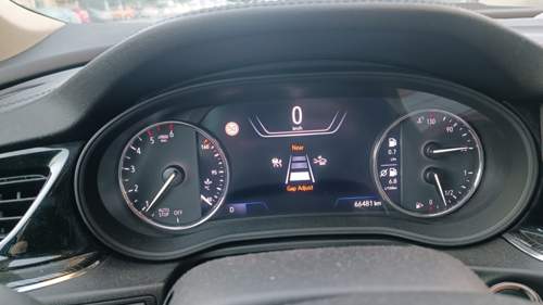

I think since update my collision alert is alerting more frequently for crash, evan for pedestrians...could it be the case?
No breaking, only audio visual alert.
Or have you changed the distance range to close
For collision alert there is no settings, only for adaptive cruise control but dont think its the same. ACC was turned off last 3,4 times when alert pop out in city driving.
But it is related to close medium far
@haseh schrieb am 9. April 2024 um 21:19:29 Uhr:
This morning I did try that...icon showing is for ACC(on left) and collision alert(on right), didn't notice it before. Set it to near and no warning :-)
Insignia B distance setting
can be changed quickly with the Lekrad button
