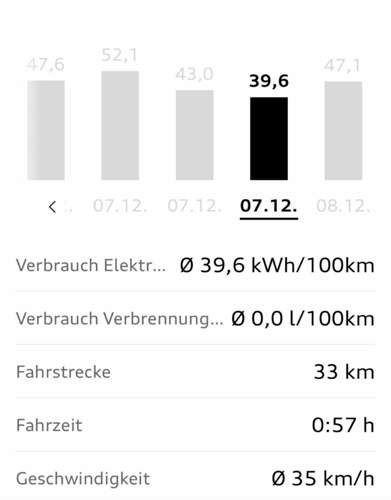

Hi, here my statistics from yesterday. 33 km at 3 degrees, the car was not preheated. I had 6 km range left. It was a drive 50% city, 50% highway. If you reach only 20km, there seems to be something wrong.
