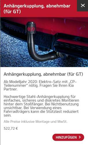

Screenshot-20190925-143304-chrome
Screenshot-20190925-144223-chrome
