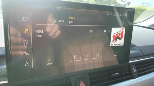

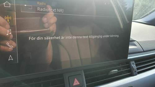

Dear Audi fans,
I got my New Audi A4 2020 with Audi Connect in end of March here in Sweden and dealer could not log in me in user and SOS buttom was red i roof. And maps did not update.
Car got upgraded software and there after radio text dissapear.
Audi connect started to work.
Went back to dealer and they asked if I can show this and yes I could since they played a song on radio took a picture of song title so I have prof (have pictures before and after update)of radio text was working before upgrade.
Have reprt this to Audi dealer in Sweden
See Pictures before and after upgrade
Bild-1-to-day-after-upgrade-driving
Bild-2-before-upgrade-driving
Bild-3-if-you-push-more
