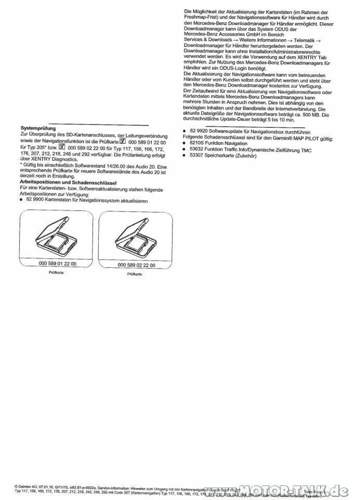

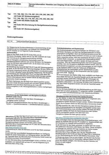

Die Mercedes Wis procedure.
Wis-doc-garmin-1
Wis-garmin-document-2
