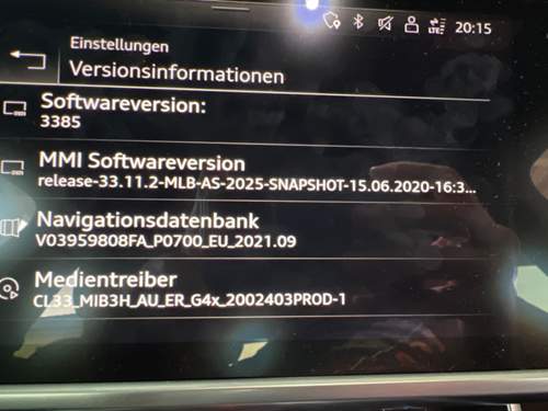

Meine Version:
V03959807C]_P0370_EU_2020.05
