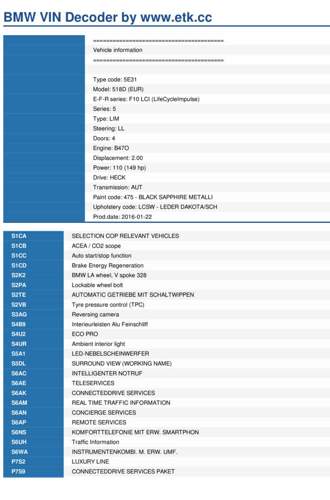

Wel i can assure you that my F10 Lci from 2016 dous not have the ambient light at the 4 door handles.
And my car has ambient light option S4UR look at the option picture.

I just checked my car.
1 : The ambient light is at full power in the I-Drive option and the dashboard light is also at full power.
2 : At night my ambient light is very visible on my 4 doorpanels , i have Dakota black interieur and my door panels are also black.
3 : i just checked my doorpanels and on top of the handels to open the door is no light bar. each doorpanel has 2 light bar for ambient light.
And BMW make some difference on some cars , because i one time already asked my dealer why on the air blower beneath the professional navigation there are 3 illuminated turning wheels (to close the air and open the air ) and the ones on the right and left side of the dashboard the turning wheels are not illuminated. He said that depends on the country and the type of car. I tought the light on left and right air blower turning wheels where broken or a fuse was broken. So at the end i took out the right air blower out of the dashboard are there are no cables for the illumination and the middle air blower has 2 cables coming in for the illumination. So all of this makes me conclude that there are differences in some BMW F10 cars.
