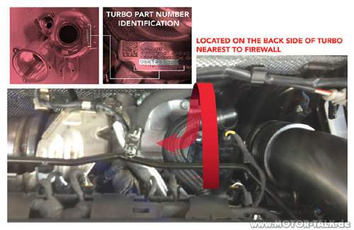

Gerade in einem amerikanischen Forum gelesen:
VAG issued a new campaign this morning replacing all of the old turbocharger part numbers because turbos were failing from the factory on unmodified cars. This includes turbos that haven't failed yet, so they are simply being proactive and replacing the turbo before there's an issue.
Here's one of the document released this morning:
www.goapr.com/support/tsb/21e7.pdf
I also was sent one from Europe from Volkswagen so I'm assuming we'll see more of these popping up to cover all models. They're probably covering their bases and making sure they have enough turbos on hand. The parts depo is apparently loaded with turbos at the moment.
Here are the turbo part numbers that fail from the factory on unmodified cars:
06K 145 702 K - Revision 1
06K 145 702 Q - Revision 2
06K 145 702 R - Revision 3
New turbo part number to fix failures:
06K 145 702 T - Revision 4
