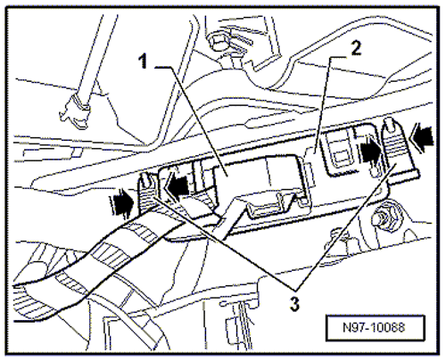

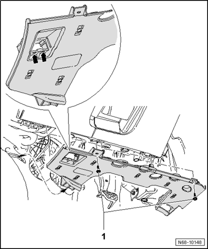

i can confirm that changing can-gateway solved battery drain issue. i also had problem with the map starting in Regensburg, new gateway (L) solved that problem to. After 15 hours of not driving the car. I started the car and the map was showing the right position (which was not the case earlier when i had the old gateway).
So the new Gateway did it for you. Very interesting. And you say you changed to an Index "L" right? What index did your gateway have before? How did you exchange the gateway? Does it have to be replaced or can it be updated?
Thanks for the info mate 🙂
yes, i´ve changed to an index "L". my old one had an "A" index. replacing the old one was very simple (its located under steering wheel, you have to take out the covering). it took me ca. 20 mins. you just need to write down coding from the old one (my old was 7byte and new is 10byte so have that in mind also).
N68-10148
N97-10088
For the firmware 266X a can gateway with index L or higher is required! If you have an index lower than L you got an drained battery...
So, my Octavia has an can gateway with index Q, thats definitively newer as an L gateway. But I've also the Regensburg issue! Why?
The dealers changes the gateways in this way (if required): K } L } Q
