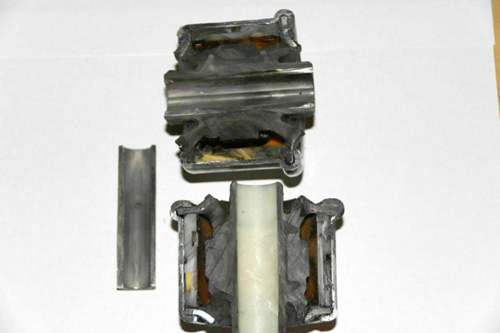

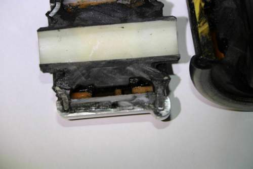

Here you have one hydrolager opened into 2 pieces.
There was brown liquid inside; almost like oil, but I can't tell the quality of the liquid 100% sure.
The liquid was spilled when cutting the lager, but I feel there was too little of it to fill in all the space inside the lager (maybe too little of it inside ?)
The hydrolager has pretty complicated construction, metal in the outer ring; then white nailon inside metal, and also nailon (hard plastic) over the center of it.
Operating principle must be so, that the liquid ( oil ?) should make a soft cushion and form a vibration damper, so that "hydrolager" should be better (more quiet) than the regular rubber lager.
Where is the noise coming from ?
Either the liquid is frozen (when temp is below -0 C ) or
then the center M12 bolt is not tightened well enough.
In both cases the hydrolager makes loud noise,
which seems to be coming from the rear passangers foot space
Sorry for English, but its too damn difficult to explain auf Deutsch
Hydrolager-1
Hydrolager-2
My opinion - both not.
Oil should not freeze at this temperature . Our cars are rumbling in the summer, too .
Are the bolts of all our cars loose, too ? I believe not.
... but I feel there was too little of it to fill in all the space inside the lager (maybe too little of it inside ?) ...
It is ok. It must be so for correct function.
See the description of the linked text.
It seems you have killed a good bearing 😁
Yes; I destroyed one hydrobushing with BLUE print, and VW service seems to throw these into scrap.
( They seem to have now instructions to change all hydrobushings to GREEN printed versions )
For example; I got this hudrobushing for free ( 0 Eur ) and they gave it to me, out of curiosity; cuz I promised to open it; and tell them what I've found out.
Thanks for the link:
https://www.vibracoustic.com/.../hydrobushing
There really seem to be "channels" inside it; when looking at it closer.
BTW:
I managed to salvage some of the liquid. It is NOT oil, that is clear now.
That was put that in the freezer ( -20C ) and then the liquid will become very stiff; ie moves very slowly. That propably is the reason behind the noise, cuz the "thick" liquid will not move thru the channels; like it does at temp +20C
Maybe they have now been using (with GREEN stamped hydrobushing) a liquid which can handle low temps better ?
Perhaps it is silicone- oil. It is clear .
Its not silicone oil; i have that at home. Silicone is very slippery.
The liquid is light brown in color (could be dirty too after cutting the bushing into 2 pieces)
I got this in my hands and I can use paper towel to dry up; and there is nothing left of it.
Its drying almost like water. You can wipe hands dry with a paper...
