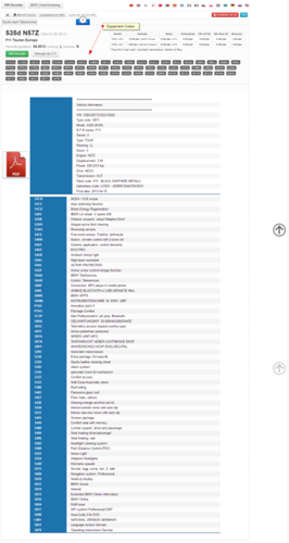

...here You find Your car's equipment listed after entering the VIN
https://www.etkbmw.com/bmw/DE/vin/decoder/online
Not sure where to look:
535i N55 (From 01.09.2009)
F07 Gran Turismo Europe
Manufacture date: 01.2010 Steering: L Gearbox: A
VIN decoderParts kits for F07
Model Gearbox Engine Final drive Antifreeze(with AC) Antifreeze Brakes
535i (SN21) 8.50l (GA8HP-45Z Auto) 6.50l (N55) 0.80l 9.30l 0.00l 1.00l
* Final drive (rear axel), Automatic transmission: lifetime oil filing
..type in VIN of Your car > enter.
All equipment codes are listed on top just below the green mark "VIN Decoder" If "S823A" is among them, You should look for the second radiator, because the hot climate plumbing is installed.

...Your post shows some spare parts listed.
When I do it, the equipment codes show up and further down the codes are interpreted (see screenshot).
Anyway, it was just to find out whether a supplementary radiator is installed in Your car.
You can check it easily - take a look through the right front grille below the headlight - You should detect the radiator mesh if there is one.
Screenshot
The list is not coming up in my case on the website. Will check the radiator as you described. The car was produced for the German market so I do not expect to have this but never know.
