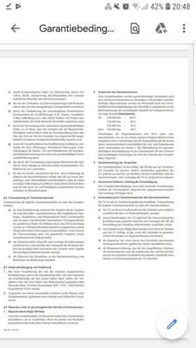

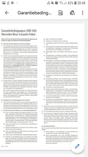

Screenshot-20190925-204847-drive
Screenshot-20190925-204856-drive
