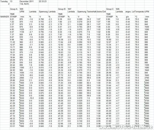

Habe eine Log Fahrt gemacht.
Habe darüber noch keine Ahnung.
Vieleicht könnt ihr mir dabei Helfen
Kriege die Datei leider nicht hier hochgeladen
8D0 907 558 E,,1.8L R4/5VT MOTR HS D02,
,Group A:,'001,,,,Group B:,'006,,,,Group C:,'007
,,RPM,Time,T.B. Angle,Ign. Timing,,RPM,Lambda,Lambda,Ign. Timing,,Lambda,Voltage,Duty Cycle,(no units)
,TIME,,,,,TIME,,,,,TIME,,,,
Marker,STAMP, /min, ms,°, °BTDC,STAMP, /min,%,%, °BTDC,STAMP,%, V, %,
,0.01,840,1.05,0.4,12.0,0.39,860,-0.8,4.7,12.0,0.81,8.6,0.145,5.9,0.93
,1.19,840,1.05,0.4,12.0,1.58,870,-0.8,6.3,12.0,2.03,7.8,0.430,5.9,0.93
,2.44,840,1.05,0.4,12.0,2.86,880,-0.8,6.3,12.0,3.26,8.6,0.085,9.0,0.93
,3.66,1440,2.00,8.7,26.3,4.08,1480,-1.6,7.0,27.0,4.49,3.9,0.765,13.3,0.97
,4.89,1200,2.30,9.5,24.0,5.28,1120,-0.8,2.3,21.8,5.79,0.0,0.695,8.2,0.98
,6.16,1000,0.90,0.4,12.0,6.56,930,-1.6,2.3,12.0,6.95,3.9,0.080,2.7,0.98
,7.36,800,1.05,0.4,12.0,7.78,840,0.0,3.1,12.0,8.16,1.6,0.780,3.5,0.98
,8.61,840,1.10,0.9,12.0,9.02,840,0.0,1.6,3.8,9.41,-0.8,0.840,14.1,0.98
,9.81,1400,2.20,10.4,26.3,10.21,1150,0.0,-1.6,22.5,10.61,-0.8,0.725,14.1,0.98
,11.05,1240,1.15,0.0,18.0,11.45,1090,4.7,0.8,13.5,11.83,2.3,0.070,6.6,0.98
,12.23,1240,0.85,0.0,18.0,12.63,1080,0.0,-1.6,13.5,13.17,2.3,0.085,3.5,0.98
,13.56,840,0.95,0.4,12.0,13.95,790,0.8,0.0,12.0,14.35,-0.8,0.770,3.9,0.98
,14.75,840,1.20,0.9,12.0,15.15,870,1.6,-3.1,12.0,15.57,-4.7,0.630,3.9,0.98
,15.96,840,1.20,1.3,12.0,16.40,870,1.6,0.0,12.0,16.84,0.8,0.465,12.1,0.98
,17.27,1360,2.30,10.4,25.5,17.71,1080,0.0,0.0,21.0,18.15,-2.3,0.770,16.8,0.98
,18.54,1200,2.90,11.7,19.5,18.94,1390,-2.3,0.8,22.5,19.37,0.0,0.760,36.3,0.98
,19.79,1800,3.95,21.7,19.5,20.21,2170,-3.9,-2.3,18.8,20.61,-2.3,0.090,91.0,0.99
,21.00,3200,6.15,59.5,18.8,21.43,2550,-4.7,0.0,23.3,21.84,0.0,0.835,99.6,0.99
,22.24,5120,7.25,85.9,25.5,22.65,2550,-4.7,0.0,25.5,23.08,0.0,0.885,99.6,0.99
,23.50,6400,0.95,15.6,29.3,23.91,2550,-4.7,-6.3,37.5,24.31,-12.5,0.890,85.2,0.98
,24.71,4480,7.00,86.4,27.0,25.12,2550,-4.7,0.0,26.3,25.51,0.0,0.855,99.6,0.98
,25.96,5240,6.95,86.4,26.3,26.36,2550,-4.7,0.0,27.0,26.78,0.0,0.870,99.6,0.99
,27.21,5920,6.75,85.9,26.3,27.61,2550,-4.7,0.0,27.0,28.04,0.0,0.900,99.6,0.99
,28.42,6160,0.75,13.9,37.5,28.82,2550,-4.7,-1.6,37.5,29.23,-7.8,0.610,0.8,0.99
,29.68,5160,0.75,11.7,37.5,30.07,2550,-4.7,0.0,37.5,30.52,0.0,0.020,0.0,1.00
,30.92,3360,0.70,6.5,36.0,31.36,2550,-4.7,0.0,32.3,31.80,0.0,0.020,0.0,1.00
,32.24,1760,0.80,3.5,25.5,32.66,1320,8.6,0.0,6.8,33.08,0.0,0.085,0.4,0.98
,33.59,960,0.95,0.4,2.3,34.10,900,-0.8,-5.5,12.0,34.52,-6.3,0.695,0.0,0.98
,34.91,840,1.05,0.4,12.0,35.39,870,0.0,-3.1,12.0,35.79,-1.6,0.175,0.4,0.98
,36.30,840,1.05,0.4,12.0,36.68,860,0.0,-2.3,12.0,37.07,-1.6,0.125,0.4,0.97
,37.45,880,1.05,0.4,12.0,37.87,870,-0.8,-3.9,12.0,38.33,-2.3,0.375,0.8,0.96
,38.74,840,1.05,0.9,12.0,39.18,860,0.0,0.0,12.0,39.65,0.8,0.130,0.8,0.95
,40.04,840,1.05,0.4,12.0,40.47,860,0.0,3.1,12.0,40.91,3.9,0.110,1.2,0.94

Habe auch mal ein Log von der Drosselklappe gemacht er zeigt mir an
Leerlauf
Teilast
Anreicherung
Er zeigt mir im Log keine Volllast an.
