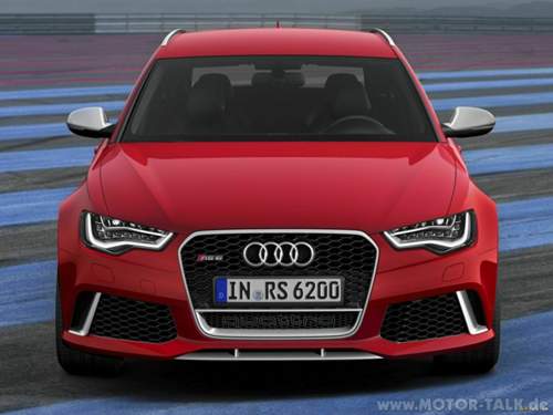

Believe me leave it. Don't fu_k RS6, ...get Vauxhall for losing pressure 😉
Wallpapers-audi-rs6-2013-1
Img-0413-jpg-klein-7542657817875932336
