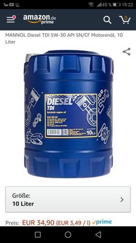

Mannol 5w30, alle 15Kkm
Screenshot-20190411-192216
