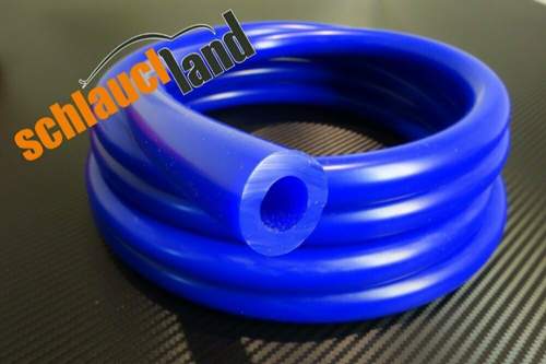

The only thing that comes to my mind is to mount a silicone hose over the PVC hose.
Did you remove the internal plastic of the fender too?
Silicone hose,hmm?!

That's really good. If my silicone hose history does not work, I will definitely buy it.
Silicon hose ist flexible to 1mm.
Unterdruckschlauch
You have to try, let me know what you did.

I repaired the hose on the weekend with the repair kit from VW, because I ordered too narrow silicone hoses.
