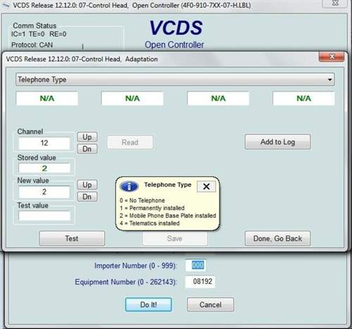

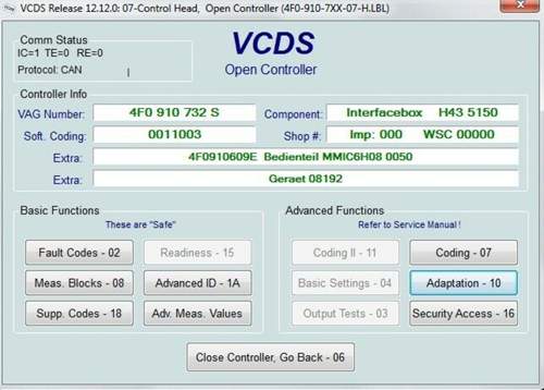

Hello colleagues,
First I want to apologize about I write on English, but my German is very weak. I read all coments and I made the exchange from fixed telephone Motorola to BT hadsfree. So I take the module with part nummber 4F1 910 336B (with SAP) and I made all the wire exactly it was described. The BT module is running now but I have a problem with the coding. I made this coding (please if I made something wrong just let me know):
1. 07 Control Head -> Adaptation 10 -> Channel 12 -> new value 2 -> Save
2. 19 CAN Gateway -> Installation List -> CHEK 77Telephone and UNCHEK Telematics -> Save
3. 77 Telephone -> Coding 07 -> New coding 0050001 -> Save
4. 77 Telephone -> Adaptation 10 -> Channel 133 -> New Value 1 -> Save
5. From Hidden Green Menu -> Hi Codirung -> APK 0x01, 0x0B ... -> Telephone make -> UHV/BTA -> Accept changes
After all this coding the module is running fine and I pair my iPhone 5 and can use all functions. The problem is when I take out the ignition key and after 5-10 minutes all coding from BT module 77 is gone. When I start the engine and press TEL button on the screen is write "Your Telephone is switched off" and I can't turned on. And the soft codding for 77 Telephone is back to 0000000 ? After that I notice that all field in coding window was fill with nulls (attached pics). I was with MMI soft 2120 and yesterday I update to 5150 (CD1 from 5570) but the MMI don't recognize the BT module. In Hidden RED menu (doesn't have name) only write 0x0103 (attached pics)? And the update don't run on the BT module, just update the another modules but not the BT. After that I tried to update with CD2 (update only for BT module) but again no update for this module. When I try to update to 5570 again no update for BT module. Now I am still on version 5150 and I don't know where is the problem. I attach pictures from VCD sreens and MMI screen that can make it clear the situation. Please can someone help me with this. How I can make codding to be permanent? May I fill all field in 77 Telephone -> Coding 07 -> Soft coding, WorkShop Code, Importer number, Equipment number?
I want to notice that when I go to Hidden Green menu -> TELEPHONE -> FBLOCKS -> on the screen is write "Telephone not yet unlocked!" is there CP for this module? If I check the box "BTA debug FBlock"?
I want to thank you in advance for your help!!!

After reading about your issue I think your BT Module is maybe defective. Especially the fact, that you can see it in your update menu but it cant be updated seems little strange to me. Do you have the possibility to try another one?
I have the same issue on my BT-module. In my case the BT- Module is broken from an older update, the former owner of the car tried.
There is a chance an update will damage the BT-Module and it will not work properly anymore. Settings are not kept and on each power-on the Phone has to be reconnected.
Since my phone does not support SAP (phonebook used from the phone), I live with the issue.
In Germany used BT-Modules are more expensive than new ones from Audi, if this is the same in your country, you could try a brand new one. Updates on this should be done by Audi, since they could become broken easily while being updated.

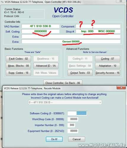

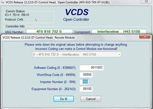

Thank you about your help. I am wondering it is possible to update manual the module with CD2 from update package 5570? Or it is possible to re-flash the module with another software (VAS or another)?
I am thinking about to insert coding numbers in another fields for WorkShop Code, Importer number, Equipment number in coding module window? But I don't know what value should be inserted? On my mind is if the MMI recognize the module in the red hidden menu (because now is only address 0x103) to start soft update? Because now the MMI don't recognize the module? It is way to fix it this?
Thank you in advance!!!
77-telephone-coding-2
Hidenred
I have never tried to update the module in any other way besides the CD2 of the 5570-update. In my case, the update does not work (it takes ages and there is no progress until an error message shows up).
Since I don´t need the BT, I did not try to fix this on my car.
The workshop code and importer number should be any value in the allowed range. This is only a reference to the shop which changed the coding. I´m not sure about the equipment number.

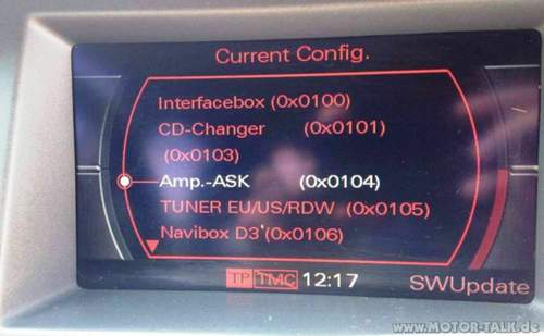

The BT only shows up as 0x103? This seems strange to me. Is the BT module correctly enabled in the gateway module?
I don´t know the english wording, but with VCDS you are able to check the optical bus for problems. If one of the devices is not acting as expected or one connector came loose, you might be able to see it there. I´m not sure if the A6 has an optical bus, so this option might not be available.
Where did you find the coding for the A6?
What is the message of VCDS after saving a coding? Does is say, the coding was valid/accepted?
Thank you for the answer.
Yes my Audi A6 has an optical but, and tomorrow I will run the test and post the result. I find WSC for my bluetooth module and inserted and the module accepted but the resul was the same. When I turn off the ignition key or restart the MMI all coding and WSC reset to Zeros. The coding for Can gateway and control head is the same like Audi A8. For 77 Telephone module the coding is a little bit different but when I inserted the mesage from VCDS is "Coding was valid/accepted", there no error messages. For me is strange that the module in VCDS screen that I attached in my previous post doesn't have a name (I pointed with "? ?" ). I don't know how ot is possible?
