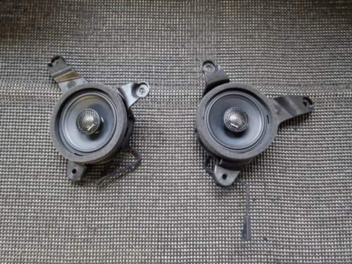

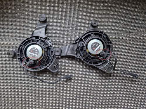

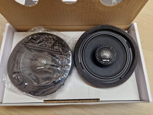

I hope you don't mind I'm writing in English. I have Advanced Sound System and what disturbs me most, it's the "mushy" bass.
Initially I was thinking about only installing some crossovers cutting off higher frequencies for frontbasses, but then I decided it would be better to improve also high tones and use more complex solution. So I'm thinking about Gladen Mosconi GA-SU-MB-206-BASIC and I have some questions.
If I understand correctly, the rear speakers are working with the new Pico DSP amplifier. Is it worth to replace them with better ones? Will that make a difference for the driver and front passenger (I set fader 0)? If so, what speakers would be a good choice for rear doors? Visaton B-80 or rather some coaxial? What switch would I need to install?
I'd like also to ask if anyone has installed any additional soundproofing and if so, is it a significant improvement?
Thanks in advance for any help.
Hi @mc-marty,
soundproofing is definitely worth it.
If you have already decided to install a Gladen Pico 6/8, then it is also worth improving the rear doors, whether Visaton B-80 or something else you have to decide, I will simply advise HELIX Ci3 C100.2FM-S3 with adapter rings HELIX CFMK100 MB. 1 and extension adapter HELIX CWK MB.FX-550CC Order and install everything Plag & Play.
The only thing you have to do is adjust the brackets a bit. See the picture below marked in red.
I've had good experience with it and haven't had any problems yet.
I hope that Google Translate translated everything correctly.
MfG. Klevik
