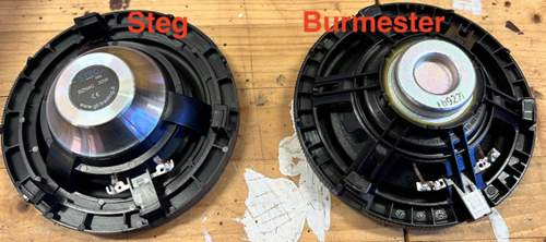

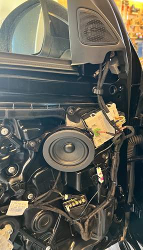

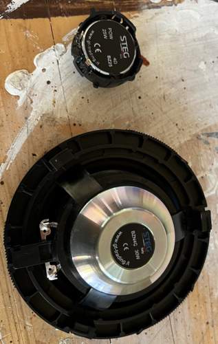

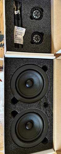

I just received the Steg BZN4C speakers for the doors and Steg BZ25 tweeters.
My C300 was fitted with the very crappy standard sound system, but I have fitted Burmester drivers in both front and rear doors and Burmester tweeters along with a crossover.
I bought the Steg components out of curiosity and paid 161 EUR total.
If the difference is small, then I will not have wasted too much money.
Will fit the Steg speakers sometime in the coming weekend, and will report back here with what I find.
I am also thinking about replacing the one bass-speaker with better ones, but need to find a suitable amplifier and wiring harness before that is done. The car is leased, so I am hesitant to make too many changes.

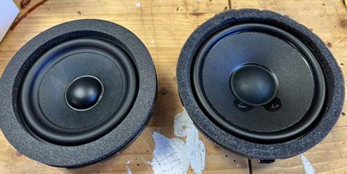

Installed the Steg speakers in my car this afternoon.
As I already had installed a crossover and Burmester tweeters, it did not take long to add the new speakers to the car.
I was hesitant to replace the W206 Burmester tweeters (not identical to the W205 tweeters), as I was fairly satisfied with them, although they were a bit aggressive.
Overall, I am quite happy with the change.
I would not have thought it, but there is a much better defined low-end now (of course not the deepest frequencies). I can best describe it as I hear less of the crappy 6" bassdriver currently fitted in the passenger footwell.
Midrange has been improved as well. It is slighty more laid back compared with the Burmester drivers.
The Steg tweeters are much less aggressive than the W206 Burmester tweeters, while still providing a nice addition to the high end frequencies.
If you are considering upgrading your standard or advanced system, I highly recommend going with the Steg speakers instead of the Burmester speakers.
Next step for me will be to replace the 6" bass driver in the passenger footwell and add one to the driver's footwell also. That will require a separate amp, and I am currently looking for a 1/2 channel amp with hi-input to be connected directly to the speaker connector coming from the MBUX system. It must also be small enough to be mounted behind the glovebox.
