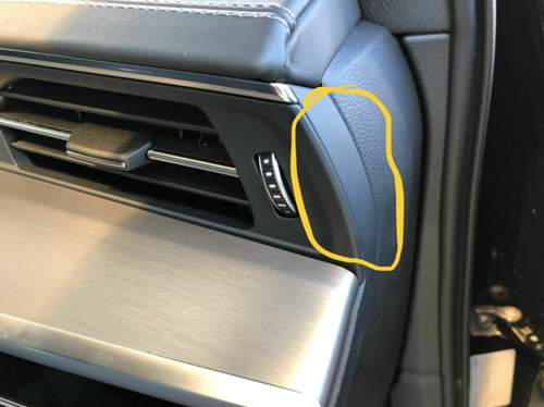

Konnte das gelb umrandete Teil als Geräuschquelle lokalisieren. Es knarzt/knackt auf Berühren. Wenn der Beifahrer die Finger zwischen geschlossener Tür und Rand vom Armaturenträger steckt, ist es ruhig. Armaturenträger selbst knarzt nur auf Druck oben/unten.

The noise on the right side of the dashboard was my only problem that i had until now , but it was really very annoying... it made me crazy... when the car was in the parking in the direct sun , the first 10 minutes you drive with it and the airco was active than the both black plastic pannels ( middle with air flow and right one with music speaker) they cracking like hell...
I have solved this very simply myself , i removed both pannels very gently using a knife , working in small parts and pulling very gently , this works nice and easy. The pannels are attached on metal clips ( see picture ) that are pushed in the base frame of the dashboard , on the cracking pannels there are plastic pins that are in these metal clips , the noise is from these ...
I removed al the metal clips , in that place a little dot of silicone kit and then i gently assembled the plastic pannels back, it is 100% perfect and now i have ride already +/- 1500km i that situation , problem is 100% gone , so i am very happy with it. took me 30min work.

just on next to every metal clip one smal dot ( don't use to much , than it is no problem to remove the pannels in the future if there is a problem... ) of this kit :
https://www.tec7.be/nl/producten/trans
@scoty81 schrieb am 23. Mai 2019 um 14:59:58 Uhr:
And how have you open the pannels? Have you more details?
i have used a regular knive , no sharp knife ! Gently push it +/- 8 to 10mm deep between the panels and flip gently bit by bit , do this every 50mm on the whole pannel and it comes out no problem.
Attention , there are some clips in the middle of the pannels too , so if you did the boarders than you can flex the pannels a bit and do the middle ones with your hand/fingers.
i'm sorry that i have no more pictures...
Sikaflex 221 is also suitable for such purpose. But don't take to much, it's a really good stuff! 😁

Dieses Knistern/Knacken bei thermischen Veränderungen - also Auto steht eine Weile, Sonne scheint aufs Armaturenbrett, man fährt los und die Klimaanlage fängt an zu arbeiten - diese Geräusche kommen eindeutig von den Gittern unter der Frontscheibe.
Wenn man daran rumdrückt klingt es genau so.
Man kann die Gitter an den Seiten kräftig herunterdrücken, dann verschwindet dieses Knistern/Knacken erstmal.

Also bei mir kommt es eindeutig aus dem Bereich unterhalb der rechten Ausströmers. Es kommt bei mir nicht aus dem Gittern unter der Frontscheibe.
Zurzeit hilft es, wenn man direkt unter dem rechten Ausströmer auf den Armaturenträger drückt (also das Teil mit Alu).
ich hatte es zuvor mehr rechts geortet, weil der Sohn die Finger dort reinsteckte und es aufhörte. Letzte Woche habe ich es aber mit einem Freund (übrigens auch 4K Fahrer seit kurzem) an der jetzigen Stelle geortet. Der Verkäufer hatte zuvor auch einen etwas schief eingepassten Armaturenträger entdeckt...
Nächste Woche nach dem Werkstatttermin (Ausströmer nicht vorrätig...) kann ich mehr berichten.
