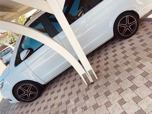

V250 4matic
RC Design RCD17 8,5x19
Vorne ET44
Hinten ET38
Traglast 900kg
245 45 R19 102
Rcd17
