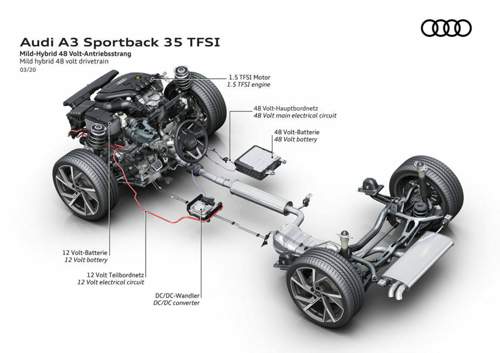

I spoke with owners of Audi A3 35 TFSI S-tronic mild hybrid and Seat Leon 4 e-tsi: several people have exactly the same noise. But some don't. I would like to locate which element makes this noise. when we have located the element that makes the noise we can replace it to see if there is a manufacturing defect
I found a technical drawing of mild hybrid technology (here on audi A3 but it's exactly the same on the golf 8 e-tsi):
Systeme-mild-hybrid-a3
