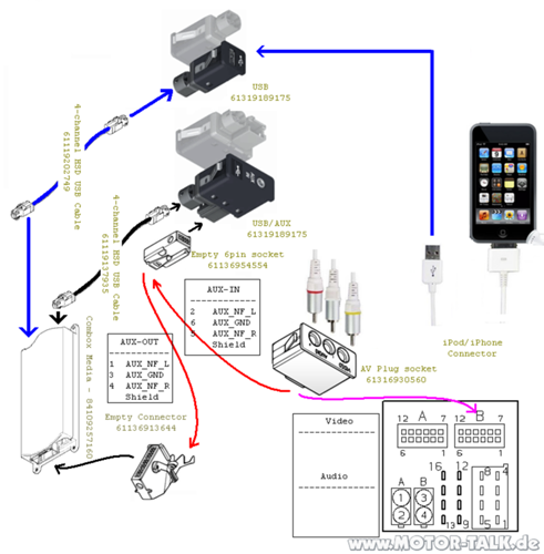

Nun spiele ich mit dem Gedanken mir eine andere Gundplatte zu holen und ein zusätzliches Kabel (für USB) an meine Combox zu verlegen. Video brauch ich nicht. Die Qualli ist mir viel zu mies. Zur Zeit funktioniert ja "BMW apps" über den USB Anschluss in der Mittelarmlehne.
Kennt jemand von euch die Teilenummer des Kabels? Die von der Grundplatte lautet 84 10 9239396 ,glaub ich. Kostet bei BMW ca. 110€.
Wenn das klappt dann wäre das die Nachrüstung für "6NF" was ja laut BMW nicht möglich ist.

"Combox Retrofit Part List
These are the Parts I needed to retrofit COMBOX:
84109257160 Combox Media: (you my be able to use the Telematic Version)
84212218390 Media Snap In
84109243209 Video and USB capable Baseplate from X5 Perfect for all models!!
61136913626 &
61136913644 Empty Combox Connector to pin the TCU wires in
61119137935 4-channel HSD USB Cable with Black Connector, from Combox to USB/AUX (my pics show another)
61119202749 4-channel HSD USB Cable with Blue Connector, from Combox to Baseplate for 6NR features
61319189175 USB/AUX Connector (it must be this switchable one to provide audio in over aux and audio from Baseplate over the same wires!!
61136954554 Empty 6-Pin Connector to wire audio lines from Baseplate and to Combox
61119200890 Fbas Video line from Baseplate to CIC for 6NR Video
HANDMADE 3wires (ideally Shielded & twisted) from 6-PIN Connector to COMBOX (L/R/GROUND)
HANDMADE 3wires (ideally Shielded & twisted) from Baseplate to 6-PIN Connector (L/R/GROUND)
Below are pics of the new Baseplate. In my e60 it is mounted in this frame which is mounted inside the armrest.
You can also see the antenna cable, the new 4 channel usb connector (BLUE) for 6NR and the wires of to the 18 Pin connector which I have disassembled here. We need to add the corrosponding wires at the other (car) side of the connector."
