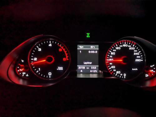

Moin, dann habe ich es endlich geschafft ACC für meinen Audi A4 8k 2008 2.0 TDI CAGA mit JJG Getriebe nachzurüsten 🙂 War ein langer Kampf wegen anderer Getriebeübersetzung als der Audi A4 8k der ACC hat (ab 11.2008 glaube ich…). Unten gibt die Anleitung ohne Getriebeaustausch 🙂 Aber auf Englisch weil Deutsch nicht meine Muttersprache ist und vielleicht haben auch andere Interesse daran…
As mentioned above, I wanted to retrofit ACC. After doing everything according to instructions in this thread etc. and flashing the ECU with new software, the gear indicator in the instrument panel disappeared and ACC was disabled in 5th and 6th gear (where you would really need it). After a lot of research, I found out that the gear ratio was changed before the version with ACC was released. KXP is the number of the new manual gearbox with longer ratio I believe… In some Italian forums, they have managed to retrofit this, but only after changing the gear box. I have finally managed to do it with only changing the ECU software 🙂 It took A LOT of reverse engineering and trial and error editing the flash file.
My original configuration:
Audi A4 Avant 8k 2008 2.0 TDI CAGA 143PS and JJG manual gearbox – First time registered 01.06.2008.
ECU HW: 03L 906 022B SW: 03L906022B version 9970
(No responsibility taken if this does not work on your car, and if you really want to be 100% sure not to get IMMO problems or similar, you may consider to extract the ECU and backup the complete SW with internal flash and EEPROM in bootmode.) However I did it according to below without any issues… NB! Important to ensure stabile voltage during flashing! E.g. connected to power source or (not optimal) good status of battery….
Step by step guide:
After having done everything according to the standard ACC retrofit guides, do the following to adapt gear ratio.
1. Read out the Internal flash data of your ECU SW xxxB, 2048 kb. You can e.g. use Galletto FGtech v54 via OBD. Bootmode was not required for me.
Flash the ECU to a SW which supports ACC. SW xxxB does not support it. I used MJ version, and flashed with VAG CAN Professional. Flash files can be downloaded via e.g. erWin in the frf format.
New SW: 03L 906 022MJ version 9335

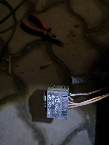

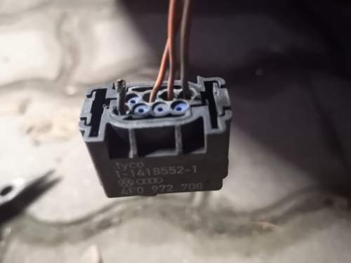

Radarsensor 8K0 907 561 von der Bucht
Halter 8K0 907 574 B
je 2 Schrauben N 103 471 03 und Blindnietmuttern N 909 203 01
Stecker 4F0 972 708
und ein neues Luftführungsgitter
Radarsensor montieren, Kabel in den Innenraum legen, codieren, justieren, fertig!

Kurze Rückmeldung, gestern habe ich die Reparaturleitung vom Sicherungsträger (Fahrerseite) zum Radarsensor gezogen. Der Abstandstempomat funktioniert nun wieder fehlerfrei.
Der tatsächliche Verlauf der +12V-Leitung verläuft übrigens über den Kofferraum und ohne jede Steckverbindung bis zum Radarsensor. Die Reparaturleitung habe ich jedoch nun durch das Amaturenbrett gezogen.
Ist dein Problem seither erledigt oder inzwischen wieder mal aufgetreten?
Hab bei meinem das exakt gleiche fehlerbild wie du damals.
Hab es nun repariert bekommen, war leichter zu beheben als zuerst befürchtet 🙂
Es war ein Kabelbruch der Plusleitung,
direkt am Stecker zum Radarauge.
Hab es mit einer neuen Reparaturleitung inkl. Pin eingelötet, funktioniert nun wieder einwandfrei.
