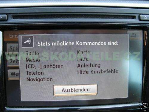

Laut vwnavi.com sind es die folgenden änderungen:
voice controle
speed limit
on display together OPS and rear cam ( like audi)
SDHC 32 GB
swich off display
menu for setings climatronic on screen
clock of displey when is rns or columbus shut down.....
