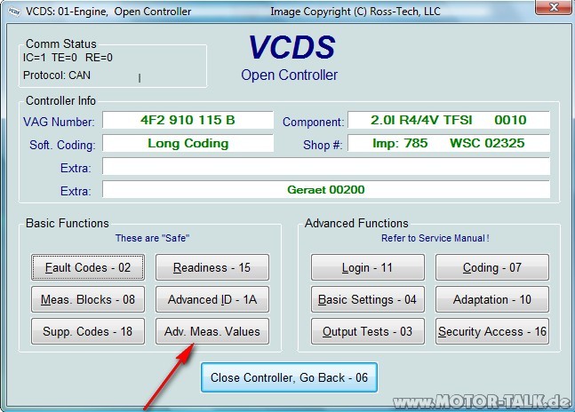

Hast du mal die Advanced ID zur Hand? Hier meine:
Address 42: Door Elect, Driver
Control Module Part Number: 5Q0 959 593 E
Component and/or Version: TSG FS 020 0041
Software Coding: 003B9220D200048000001000
Work Shop Code: WSC 01357
VCID: 43BD6C24CA54555AFD-8017
Advanced Identification/FAZIT
Identification: KO9-MAL
Date: 30.05.16
Manufacturer number: EEU0
Test stand number: 7972
Flash Status
Programming Attempts(application): 0/0/1
Programming Attempts(data): 1
Successful Attempts(data): 1
Flash Date: 00.01.01
Flash Tool Code(data): 00200 011 01357
Misc.
Hardware number: 5Q0 959 593 B
Workshop System Name: J386
Equipment/PR Code: FFFFFFFFFFFFFFFF
Dataset Number: 5TA222v____
Dataset Version: 0016
ASAM Dataset: EV_DCUDriveSideEWMAXKLO
ASAM Dataset Revision: 006003
VCDS Info:
Labels: 5QX-959-X93-42.clb
ROD: EV_DCUDriveSideEWMAXCONT.rod
Wo finde ich die?
