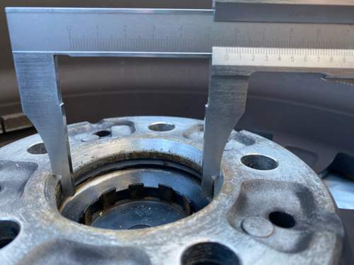

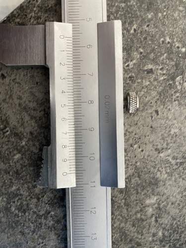

for whose who are interested : 18 inch BMW OEM ronal 66,74-66,76 with vernier caliper
@Frenchstqr-57 schrieb am 20. August 2022 um 19:38:55 Uhr:
Laut diesem Messschieber sind es 56,75mm
@DanielMI6 schrieb am 20. August 2022 um 21:11:23 Uhr:
interior mesaures your hqve to reqd the 0
exterior measures you have to read the 2
