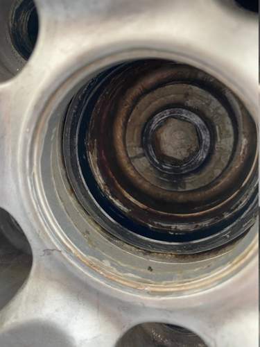

update : after several tests, the root cause for me was the wheel bore tolerance, that measured 66,76mm instead of 66,6, the root cause is the play between wheel and hub that is 0,15mm too much.
the wheel centering is the most important action when it is perfectly centered, the friction disc are relevants.
with 3M temflex 1500, one layer of 0,15mm and grease, i succeed to do a perfect centering checked with metal shim
i can affirm that i have the bests results with frictions discs + one layer temflex 1500 and grease than friction discs alone.
i will try to replace the 3M tape by a 0,15mm ring with a feeler jauge tape , in german "FUHLERLEHERENBAND"

according to bmw on F10 models : Play at the wheel hub greater than or equal to 0.15 mm is outside the permissible tolerance
i think that it is the same tolerance for the G30

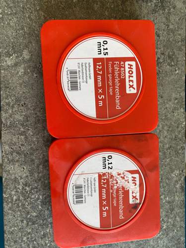

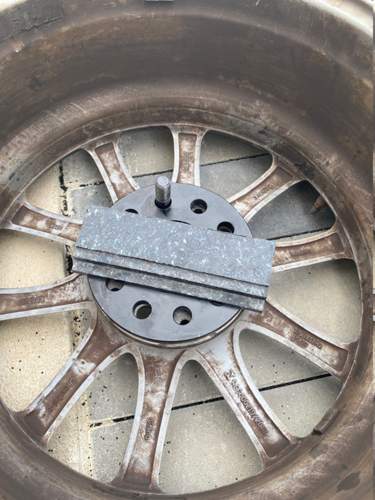

for me Problem solved with only FUHLERLEHERENBAND 0,12mm, without frictions discs
no vibrations remains

For correctness sake: spelling is *Fühlerlehrenband, as it says on the label (english terms can be feeler gauge tape/strip/stock/foil).

A. Die Fühlerlehre füllt den Spalt zwischen Radnabe und Radnabenbohrung, so kann sich das Rad nicht bewegen/vibrieren. Es besteht also Formschluss.
B. Die Reibscheibe erhöht die Reibung zwischen Auflagefläche und Rad um Bewegung/Vibration zu verhindern. Der Ansatz ist also hier Kraftschluss.
Mir scheint Lösung A fast sinnvoller, weil sie direkt an der Ursache anfasst, statt einen "workaround" zu bieten.
Dafür ist vermutlich das Anbringen/die Montage nicht ganz so einfach richtig hinzubekommen. Das muss schon sitzen.

@Frenchstqr-57 schrieb am 19. August 2022 um 10:49:07 Uhr:
Respekt! Du hast dir quasi selber Zentrierringe gebaut und noch welche aus Metall. Top!

How did you mount the feeler gauge tape? I guess that was not so easy...?!

I insert the tape gradually between the wheel and spacer, without spacer i think that you have to be good with your hand, it is possible to do this but this test is a proof of concept, i think the best thing to do now it's to make this ring by a professional with a CAO model
