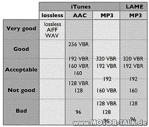

Richtig. Meine Persönliche Beobachtungen:
http://www.hifivoice.com/audio/ipod/compression/compression.html
(In English) my own observations are that 160kb/s AAC or 192kb/s MP3VBR suffice for mobile use. 224kb/s AAC is for most material inaudible.
For critical listening in a high-end hifi situation in a silent room, lossless encoding makes sense. It can be distinguished by spatial imaging (the way instruments are placed in width and depth), treble, and the pace&rhythm of the bass. These subttle differences will be hardly audible on any hifi equipment in a car, because the acoustic situation doesn't allow for proper imaging.
In the future I'm planning to measure the Dynaudio system, so we can see technically how correct it is (which can be different from what we like).

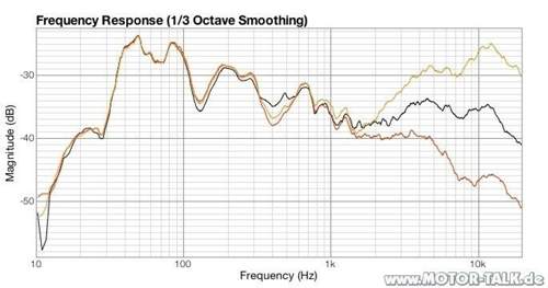

I did have some time today to evaluate the Dynaudio system. The sound is pretty OK, much better than with the standard sound system. The tweeter is a bit "metalic" sounding, and there is too much bass. It makes the overall sound balance a bit sloppy instead of punchy.

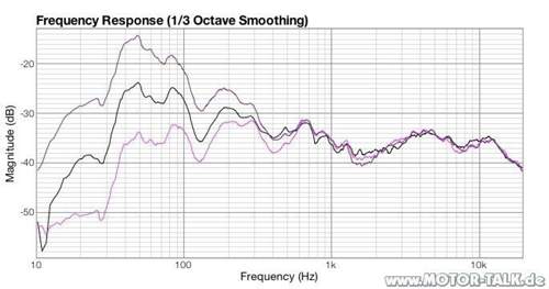

I've also measured the bass, mid and treble settings to get an idea of which regions of the frequency range they impact. I've measured at the driver seat position. Due to the car geometry, you can expect a lot of dips and peaks in the curve, due to acoustic reflections. The black line show the neutral settings. The two surrounding lines the maximum and minimum settings of bass/mid/treble.
As confirmed by the curves, the bass region requires serious attenuation. I prefer a power response curve with a tilt of about 6dB. The corresponding settings are enclosed. It gives a more tight sound, with still a lot of bass, but less sloppy. The bass is still not slamming in your stomach (hardly possible with this size of speakers), but the overall sound is much more balanced.
Sound is also a matter of taste, so these settings are my personal findings. I hope this inspires you to understand and find your own favourite settings.

You can see that the Dynaudio system is tuned for making impact by over-doing the bass. This is the case with most car-audio systems. When turning back the bass, I think the system sounds pretty decent. As far as I have heard (which may tell more about me...) auto acoustics can never be compared with home acoustics. I've never heard good phantom images in a car (i.e. be able to pinpoint recorded sound sources in width and depth in a stereo image). In my own home setup you can almost estimate the size of a church and the position of a singer. E.g., see http://www.hifivoice.com/audio/milestones/index.html.
Don't look at the peaks and dips in the measurements, most are from reflections due to the car acoustics. The slight dip at 2kHz is for real though (the so-called presence region). You can easily test this by measuring with the microphone at several places, the peaks and dips should be placed at other frequency regions in that case, which I did check. These measurements have been performed quick and easy, out of my hand. To get an impression, this is good enough as I've also encountered during speaker design.
